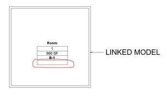

Hello all,
I am currently experiencing an issue with a room tag calculation.  I have created a tag that calculates the Occupant load and it works perfectly well when used in the model that has the room, but when I link the model and set up all the same project/shared parameters it simply does not calculate the value.  Is there a work around for this?  See below for more information.  Thanks.

Hmmm, I do not believe that is the issue.  If I create a room in the model with the link the room tag functions as it should but the linked room still does not calculate.  See below for reference.

I see your formula only allows for 100sf occupant load.  The problem with this solution is other rooms will have different occupant load factors. So while it works for an occupant load of 100sf if the room were to have a 300sf occupant load factor then you would have to have another tag to accomplish this task in a linked model.

I just encountered thesame issue with use of shared parameters in a Formula.
After some testing the following conclusion:
Shared parameters in Formulas (in tags) only work for linked models if the Shared parameter has thesame internal id! so the formula doesn't check by Name + GUID, which is why we use shared parameters.
So builtin parameters work, becaus they always have identical id's.
For shared parameters to have identical id's, the models need to originate from the same source file (Template or copy of existing model)
Seems to me this is a BUG in the formulas, as reading the shared parameters directly without formula DO work if added later, so with different id's.
Hope it's bit clear, tested in Revit 2020 (2020.2.3)

Ok, seems to be solved in Revit 2021.1.1 version
see: https://knowledge.autodesk.com/support/revit-products/troubleshooting/caas/sfdcarticles/sfdcarticles...
I can confirm it is solved for Room Tags (haven't tested others), the parameter doesn't even have to be in the Host to work.
