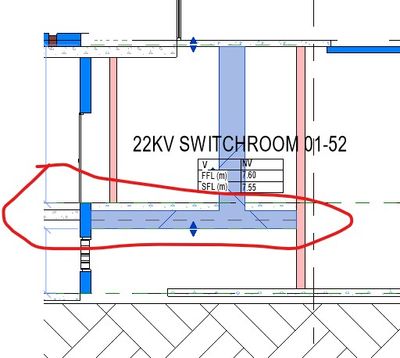

Room's lower offset is above the Computation Height

i cannot add room name above the below room. i already adjust the computation height of the level. and cant adjust the limits with error. how to solve this? thank you

What do you mean you can't " add room name above the below room"? You mean you can't create a room on the level above? Or you can't offset the upper/lower limit of the existing room to include both levels?
...btw: Computational Height has nothing to do with either of the above.

Set your Room to calculate Area AND Volume.
