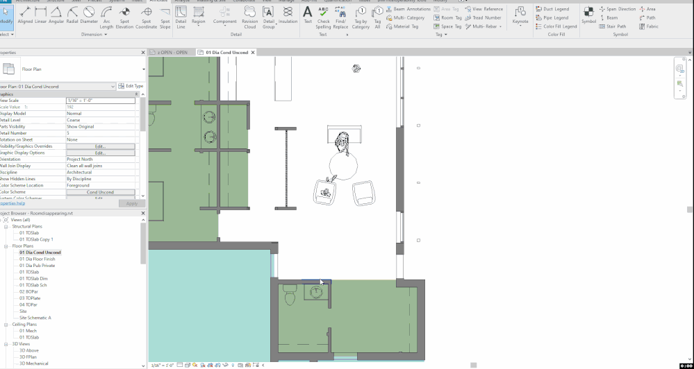

I have an old file that was working and now one of the rooms has disappeared in view and will not show up unless I draw a wall in the middle of the room.  Very strange.  I'm hoping there is an easy answer for this mystery.
Here is a link to the video that shows what is happening....
https://youtu.be/ieQdKn1rjCY

Change the Room's Upper Limit Offset.

Hidden in the View by Element?
...Reveal Hidden Elements

Boy, this one is a head-scratcher.  What about deleting the Room and recreating it?  What happens?  Same thing?

I was able to correct it by working through and resolving Warnings.

Fix the Bounding walls at the WC/Half Bath..
  1. either use one wall (and use an insert for the opening)
  2. or make both Not bounding  and extend the Room separation
  3. Or use one wall which is bounding + edit its profile to create the Opening

Not really...don't think it is even related. the 2 walls of the Half bath has no warning...I simply placed a section and noticed the below...too many bounding elements (none overlapping)...simplifying that spot fixed the issue

The WHY should not be important at this point :leicht_lächelndes_Gesicht: what matters is the bigger picture, the HOW?
Although the 2 walls causing the issue did not have any registered errors, you still managed to solve the issue as suggested by going through the whole list of errors without knowing which or if any caused the issue.
