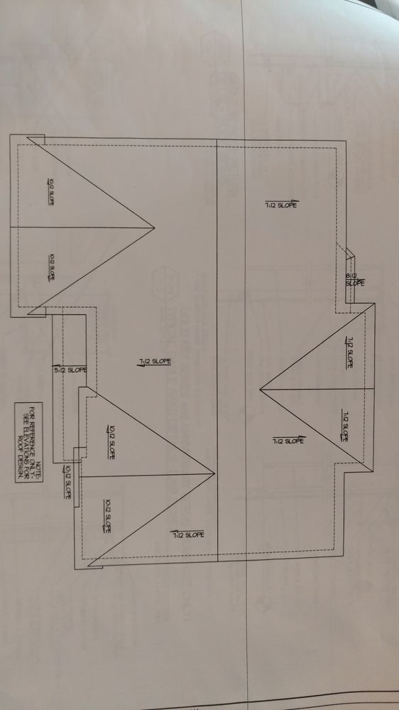

Hi All.
So question or issue I am having on a portion of my complex roof I cannot figure out. I put a basic gable roof that has a 7/12 pitch and the gable looking at east elev. ridge line is supposed to be inline with west elev. gable ridge line (see screenshots). The roof line was correct east and west 1 ridge; however I had to join perpendicular gables (2 10/12 slope; 1 7/12 slope) into the main roof. All elevations and roof lines are correct; however the east portion of the main roof front slope disconnects and the ridge line moves upward like it is 2 separate roof lines? The vertical line in both screenshots is and was the correct ridge line and thus you can see how the roof disconnected the front portion of the main roof. You can also see the east elev. front slope is also down from the back slope by about 2' which enabled the main roof to have both 7/12 slopes.
How can I correct this? I tried also to create main roof w/o the front slope then create another roof that was just the front slope but then that created more issue with the gable that joins into the front slope of the roof.
TIA!
Cheers!
Rick...

Add a "Offset From Roof Base" value on one side.

Oh, it's one roof doing this? Simple fix. Remove Define Slope from the eave that is inset.

So you want condition "B" to be the same as condition "A"?
Like this?

Yes exactly. However I assume you extended the front main roof line and that is not correct on how house is actually built because the roof line overhang is in line with middle of the house roof overhang.

How about this for a quick fix?

No, I didn't change any overhang. It's exactly the same dimensions received in your file.  I just made the gable eave a Roof by Profile so I could extend and clean-up the conditions at "B".  In the field, the rough framing it will probably look closer to your original. The roofers will likely have to clean up that intersection with blocking.
Regarding your follow-up post, you can clean-up that condition where the roof protrudes through another by using a in-place void to cut it away.

Thanks again I really appreciate the guidance here! I am new to roofs in Revit so-to-speak and never really did one the complex and just really learning when to use the different options...Never used roof by profile nor the cut void you mentioned. I look into the new file and hopefully see what you did. I am assuming my existing plans with a 7/12 slope for the "main" roof are not correct because I couldn't get anything close until I changed main to roof sections to 6/12 slopes and the gables are basically 9ish/12 rather than 10/12.
Here is actual picture of roof plan and elevations and my roof only looks close and I can tell not exact at all so I really need to try other roof functions to handle offset ridge line on 1 side of house...I have looked the internet over and nothing comes close to this complexity! Maybe if I can ever figure this roof out I will create a tutorial video to post...ha, ha!
Rick..Roof PlanRoof PlanBack ElevBack ElevLeft ElevLeft ElevRight ElevRight ElevFront ElevFront Elev
Nachricht 14 von 14
als Antwort auf: rickjohnston
If these drawings are from AutoCAD then I wouldn't trust them with all my heart. The person who drew them could have skewed things so they work to his favors.
The importance to focus on is the design intent/language such as eave alignment, main roof slope, relationships between different peaks. If you meet those and have to alter the dormer slopes then it is fair enough to say you succeed.
