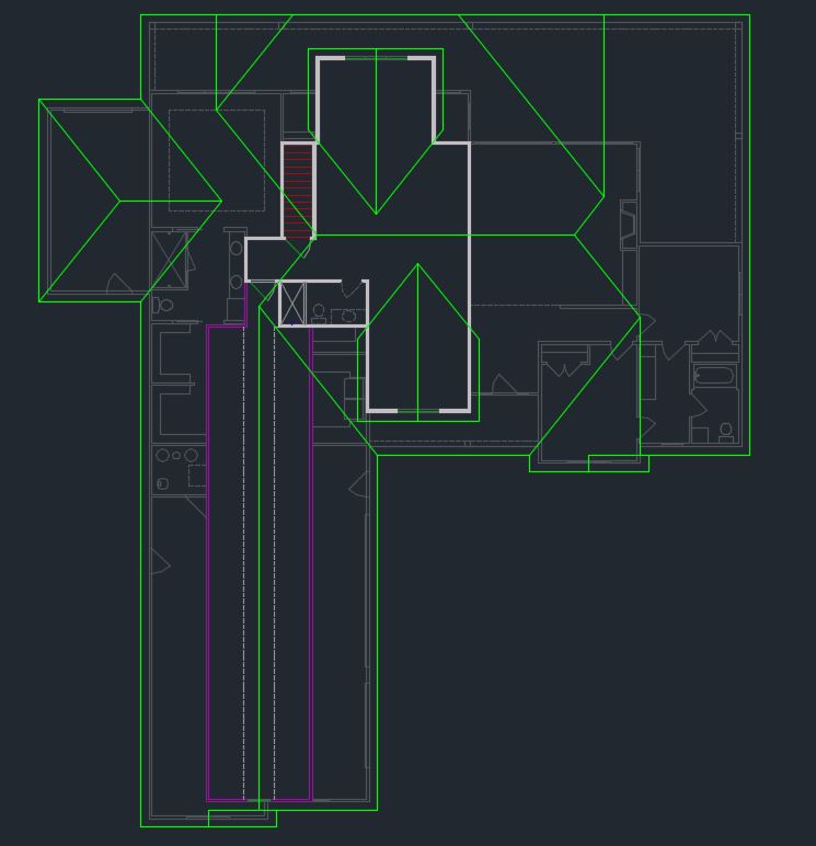

I am replicating an AutoCad drawing into Revit, and I am running into problems regarding the roof. There is a large gable on the rear of the house, but Revit is not allowing me to create this. I have attached the desired elevation, roof plan, and my current situation in Revit.

You can get there (for the most part) by using Slope Arrows.

Got it!! Thanks so much for the advice. The roof was still extending below the roof level, but realized I needed to change the "plate offset from base" in a couple of places to make it work.
