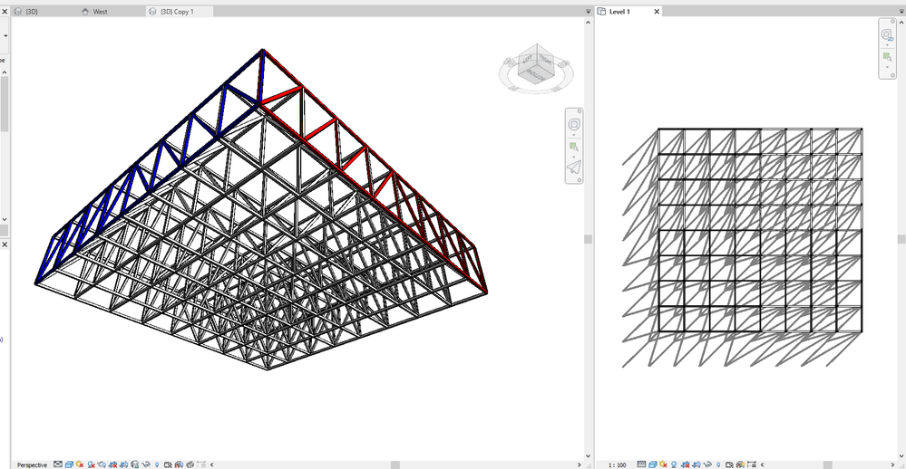

Good morning.
I need to reproduce this roof with Revit. What method do you recommend I use?
I'm trying to use the mullions, but I don't know how to make the oblique ones.
And I don't know if it's the right method.
Thank you.

Pattern-based Curtain Panels.
Google Space Frame.  There's lots of tutorials on-line.
https://www.youtube.com/watch?v=WoqzTKB0Kcw

@f.annoscia1XRNMD
You do not need to over complicate it...Mies Van der Rohe's convention center is modeled using simple Howe Trusses
