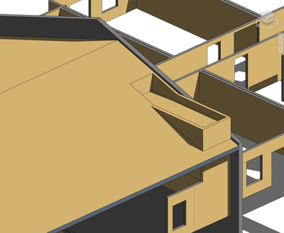

Hi everyone,
this is a desirable roof plan, 4"/12" slope. Roof portion statret B11 to the right is offset 3'-3" from the main roof plane, roof B13-B20 is the same way:
I have modeled it successfully except for a jog by the elevator shaft (clouded in red on the plan above). Looking for a solution to model it correctly. Thank you

something like this?

no Arch plan is different, see below clouded in red

I think the cause is the wrong slope here:
https://www.youtube.com/watch?v=6vx_XvggfWg
Constantin Stroescu
Nachricht 9 von 9
Thank you that worked!
