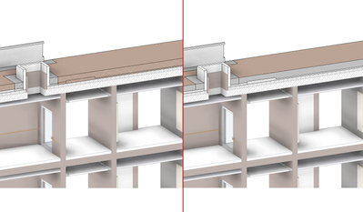

Roof cut patterns disappear when joining geometry
3 ANTWORTEN 3
Nachricht 1 von 4
1180 Aufrufe, 3 Antworten
Info:
- Roof must be modeled as roof category
- Roof layers must be separately built
- Overlapping geometry must be cut out
Tried, didn't help:
- Changing order of joined geometry
Not an option:
- Drawing missing patterns in 2D
3 ANTWORTEN 3
Nachricht 2 von 4
thomae_HuK
als Antwort auf: Anonymous
I know this one! Viewed in 3D it appears as a surface geometry. And not as a solid geometry anymore.
Nachricht 3 von 4
als Antwort auf: thomae_HuK
Hi Thomae,
Correct, material cut patterns also disappear in all 3D views.
Perhaps @lim.wendy or anyone at Autodesk knows better (might be a bug).
Nachricht 4 von 4
filip.knapczyk
Hi, have you found a solution for that? I have the same issue.
