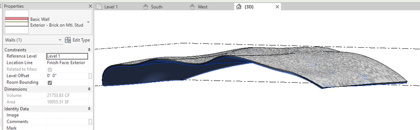

Hello so this issue is quite annoying.  I created a curved form through mass so that i can make a  complex curved roof using the roof by face tool . It worked multiple times before but when i had to delete the mass in order to make a better roof the roof by face arrow or picker wouldn't highlight the mass at all. The picker works for the wall and topo solid. The mass has a simple geometry i just wonder why it wouldn't pick it this time round yet previous masses were more complexspline through pointsspline through pointsThe created form cannot be picked by the roof by faceThe created form cannot be picked by the roof by face

when I tried this, it had to do with how the end conditions were lined up.
if they were off, it wouldn't work.
basically the same shape, but when those end condition's weren't in line, it wouldn't make the roof.  i could make it a Wall or Curtain System, but not a Roof.

hmunsell
als Antwort auf: ToanDN
@ToanDN wrote:
You said you could create a wall by face with that shape then do it.
Here it is as a Wall by Face.

careyokumbe
als Antwort auf: hmunsell
hello thanks for this but problem with a wall is you cant really attach a wall to it or maybe i just dunno how to attach a wall to a wall in revit

careyokumbe
These are ordinary splines... how can you change the heights of those  end points
Nachricht 10 von 18
hmunsell
als Antwort auf: careyokumbe
In my simplified version, I just went into an elevation and adjusted them the spline. I assuming you made a series of splines and then selected them to make a solid form. If you make a Reference Plane or Section parallel to each spline,
you can use the Orient to View or Orient to Plane tools to set your view as needed.
The more fluid forms like that do seem to be finicky though. In my second example I had to remake the mass face and I couldn't get a roof to place. It would let me select it, but I got an error when it tried to make it. I'm sure if I played with it some I cold have gotten it to work.

careyokumbe
In instances where the roof by face can highlight the roof but brings an error of can't make roof,  i earlier realized that it can work when you go to the picked faces location and choose switch the roof facing bottom rather than top at the properties panel
