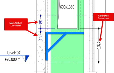

dan.luxford
@jszymborska I'm with you here. Here is my scenario, I have single service drawings with reference dimensions back to structure, grids and levels, once approved I also will need manufacture dimensions, say flange offset to a shoe. I would like to be able to get all my dimensioning done at Approval stage, with the Manufacture dimensions on a "Manufacture Detail" workset (turned off), and when approved and we go to Construction issue, we can just turn the workset on and still retain the reference dimensions. The only way I have found to get the manufacture details turning off and on is to add them to a selection set, and create a filter in the view template, but this is a far mor erroneous task.

arq_42
Worksets should not be used to control visibility; it's bad practice.
What you want to achieve is easier if you create a new dimension type (i.e., "Manufacture dimensions") and then add a filter, filtering by type name.
You can later turn the filter off and on if you wish.

TripleM-Dev.net
Hi @jszymborska ,
Depending on the needs you can use:
For all dimensions, turn dimension category off in the view (or viewtemplate)
For specific dimension (types) create a Saved Selection set which can be used as a viewfilter.
(as far as I know dimensions can't be used in Rule filters)
Note that the saved selection need to be manually updated if new dimensions are added that need filtering out.
