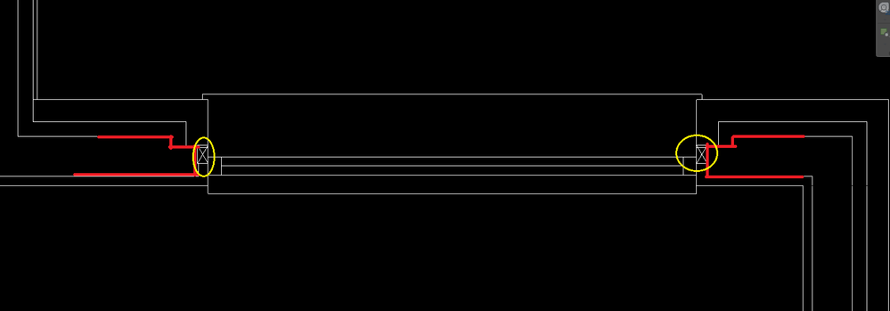

Hi everyone,
Revit windows always cut the walls in some fancy way around the reveal, it even curves the external/internal finishes inside, and it even puts a batten there, etc.
(shown in red and yellow).
Can i get rid of those stuff somehow, and make Revit to show a nice straight cut without fancy stuff? (like in AutoCAD, shown on the pic below)
Thanks!

You will need to edit the window family for that. Delete the extrusions for trim, etc.
Then on to the walls. You can then change your wall types and change wrapping.
That's as simple as you can go, though why you would want to do that to mimic AutoCAD beats me. The beauty of Revit is how close to reality you can make your model - and it's a building model, not a drawing.
I do hope that what you are asking for are your workplace standards. If this is something that you are doing just because you like it, then any collaborators working on your project will be in for trouble!

Does your window family use void(s) to cut the wall instead of a Cut Opening?

It's an office standard, i wouldn't mind this anyways, im gonna try it, thank you!
