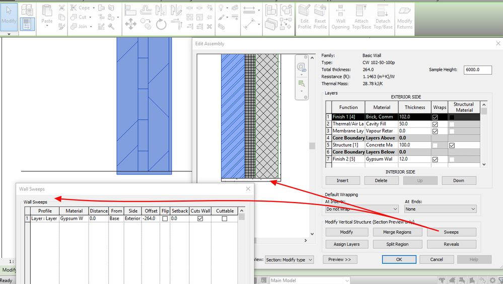

one method could be :
  • in model component: Wall > Sweep    - Wall > Properties > Edit Type > Type Properties > Construction>Structure>Edit > Modify Vertical Structure ( in Vertical section view) > Sweeps.  The Sweep Profile is made so to to fit the thickness of the wall and the thickness of the Layer
  • Other method could be a View tool : Cut Profile - a very quick method but it does not affect the model as the first method does.

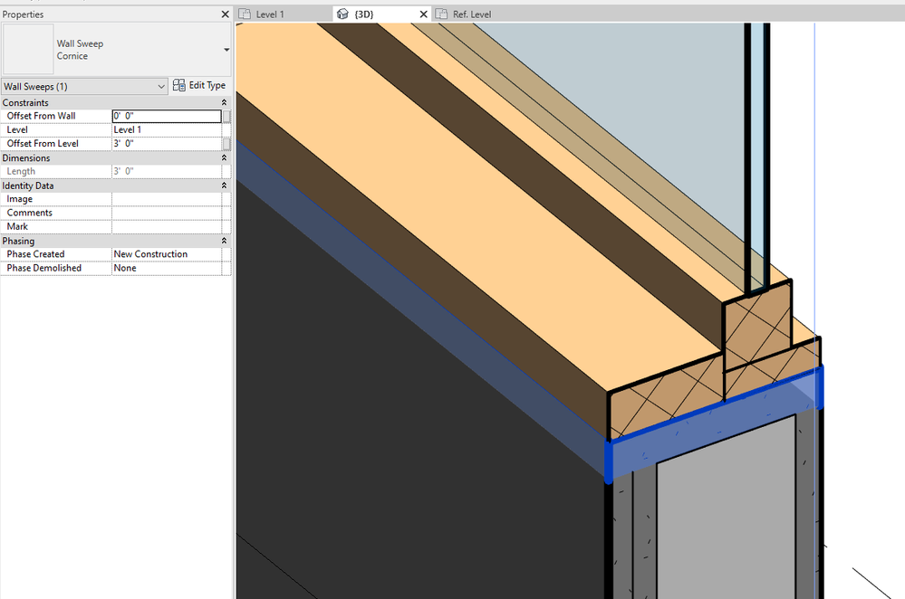

How about for openings using the same constraints from the family object as the plan shows?
Nachricht 4 von 4
als Antwort auf: nathaniel.mcmahon
Manually place a Wall Sweep above and below the opening and grip stretch them to fit?
