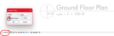

I am trying to set a custom scale in revit 2025 to look like the attached, since 120' is not a standard option, when I set it to custom and set the scale value to 1440, the scale on the drawing does not change to 1"=120'-0", see capture 2. How do I change this?
185 Views
Mike.FORM
Open the view and then click the scale in the bottom ribbon. When you set it to custom it will open a dialogue where you can change the display name.
This is not possible when setting the scale in the properties palette as no UI pop-up gets displayed.
TeresaXMJLQ
Awesome Thanks!
