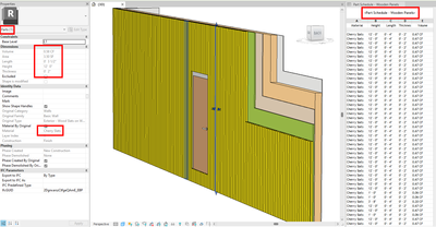

Have you ever struggled with calculating or representing patterned surfaces — especially on large projects like malls, airports, or public buildings?
Here's a trick that saved me weeks of manual work:
🚀Use the Parts Tool in Revit to divide surfaces into custom areas!
As a BIM manager working on large-scale architecture and structural teams, I often faced the challenge of preparing floor, wall, and ceiling finish patterns — with accurate area schedules and clear design intent.
Why the Parts tool is a game changer:
  • Allows you to split any system element (floor, wall, etc.) into custom Parts
  • Each Part can be visually styled and measured independently
  • The area of each Part can be scheduled automatically
  • You can export the data to Excel or share it via BIM 360 Design with clients or engineers
This tool has no true equivalent in Archicad, where I also worked extensively. In Revit, it becomes a powerful engine for precise quantification and design communication — especially in high-detail, high-volume finishing scenarios.

Let me know if you’ve used the Parts tool in a similar way — or if you’d like help applying this method in your own projects!
381 Views
Basam.Yousif
I second your enthusiasm for the PARTS tool, and I agree that it is a game changer.
Just made this last week, to explain how you don't need a fancy addon to model such items:
