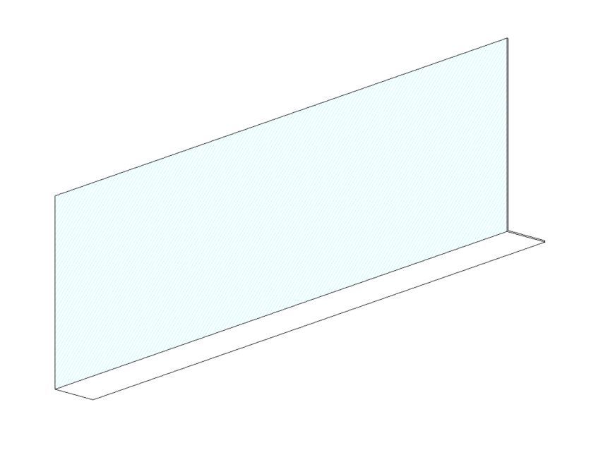

Open this IFC in Revit and change to Fine detail and tell me if you can see the surface pattern.  It was export using High Detail settings.
Message 10 of 12
jnoordzij
Yes, I can see the pattern when opening the IFC in Revit (picture 1).

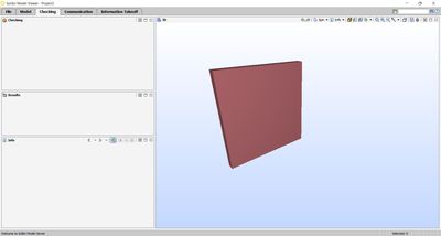

But I do not see the pattern when I open the IFC with other IFC viewing programs:
Solibri (Picture 2)
Tekla BIM Sight (Picture 3)
The latter is what I am looking for.
Most manufacturers do not work with Revit, but they can read IFC format. So the pattern information should be stored and visible in the IFC, but not necessary only from within Revit.
I hope this is possible?
IFC in RevitIFC in Revit
IFC in SolibriIFC in Solibri
IFC in Tekla BIM SightIFC in Tekla BIM Sight
