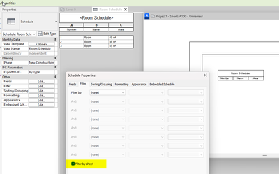

Hi any body knows why only headers and titles are visible on sheet?..i have created a sample wall schedule, then when i drag it to sheet it is incomplete and not showing the rest of the lists.? thank you in advance
please refer the screenshot.

Check if you do not have "Filter by sheet" checked in your schedule filters.
Louis

Thank you sir..
