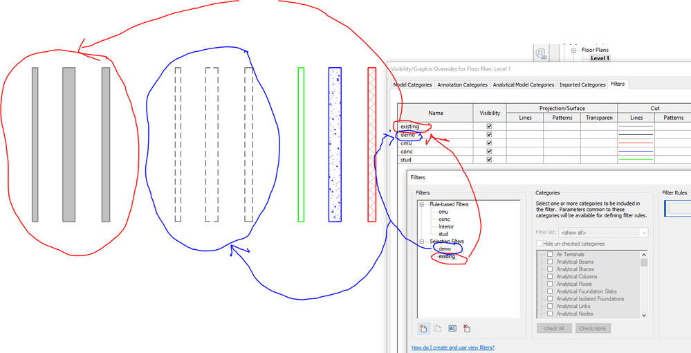

Hello
I need to make an architectural plan where the phases of the project are indicated, like the walls that will be demolished and that will be constructed, however we use a different representation pattern for walls that will be built in masonry and for those that will be made in drywall.
But Revit does not give me that option, for him, everything that is new has a single representation.
How do you work on this issue?
Consider that the attached image is just an example, the project I'm currently working on is more complex and overlapping the graphic elements individually is somewhat laborious.
Thankful

I think @ToanDN's solution is probably the one to go with interns of looking at whats overridden. If you set the new phases in the phase graphic overrides to not override the essentially you can use something like filters to override the viability per wall type to get them to display how you wish. That's what i have done for the image below. I've removed the graphic override for proposed and then added a filter to highlight each wall type. Hope this is of some use.

You can use  a combination of Rule based filters and Selection filters.  Pay attention to the order of them on the filter list.
In the example below, the line type and cut pattern of the existing and new are controlled by Phase Graphic Override.  the selection filters only control the cut line colors.

Maybe I did not use the clear terms, sorry. But the question is somewhat simple, we have a "Architecture Plan" board, in it we identify the walls that will be removed, all of them will be removed, so whatever material they are made will be removed and represented in red.
But when we build the walls, we have different types of materials, "Masonry Wall" and "dry wall", so we need to have two types of representation for New (phases), because otherwise it will not give the impression that all walls will be of the same material, and it is not.

Yes, I tested your solution and it worked for me, I want to thank everyone for the attention and especially your solution.
