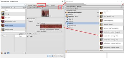

 I had from my school to work on it at home at my computer and for some reason when I took the file and went to 3d view and changed it to 3d view it looks nothing like it did before and I'm not sure why and how to fix it and also I just installed Revit, I put pictures of the last render I did at the school laptop and what I look like for me rn on my Revit.
At home in realistic viewAt home in realistic viewLast render I had what it looked like in realistic at schoolLast render I had what it looked like in realistic at school

looks like your home's Roof  Material isn't using the same Appearance Asset .
...in fact, all your Materials Appearance Assets are different

Just wondering something here: Did you open the RVT in the same version of Revit that you are using at school? You didn't by chance upgrade it to a later version when you opened it?
