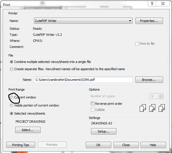

Hi all, I wonder if anyone could help.
In Revit 2017 when printing a PDF using CutePDF or PrimoPDF it seems to export it as a large file even if it's only 1 page.
I've attached screenshots of the settings we use in Revit, could anyone shed any light as to where I'm going wrong? 1 page seems to export at around 30mb in PDF format when it should be around 1mb when I use 600DPI.
I've tried reducing the DPI to even 144 and it still comes out at 11mb on paper size A3 on a 1 page drawing.
Thanks in advance.
Vian

It seems from your first attached image that you are printing a set of pages and combining them into one file.
if there are many  sheets in this set it can cause size issue..

Click Current window in Print range.

User Vector to reduce the file size, ( Raster imaging increase the file size drastically )User Vector to reduce the file size, ( Raster imaging increase the file size drastically )
