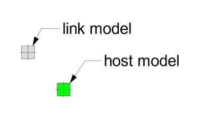

In Revit 2021 we were able to use a shared parameter Boolean to filter elements in a linked  model and give them a certain override.
This no longer works for Revit 2022 and onwards? Did things change or is this a bug? Text parameters still work, but for some reason Boolean dont anymore.

Here a few screenshots, i even copied the same element in de host model and then the filter does work, see attached screenshots. (Parameter name: Trekpaal)

i don't see any problem or bugs here, but you should control have not the duplicate variable share and not share:

Yes, the first one is Shared Parameter and the Second One is the project parameter.if i make a mistake and check the second one the filter does not working well.

You are right indeed, i added the shared parameter as a project parameter in my Link model. (I added to the wrong caterogy... My bad)
Now i can filter override the elements.
