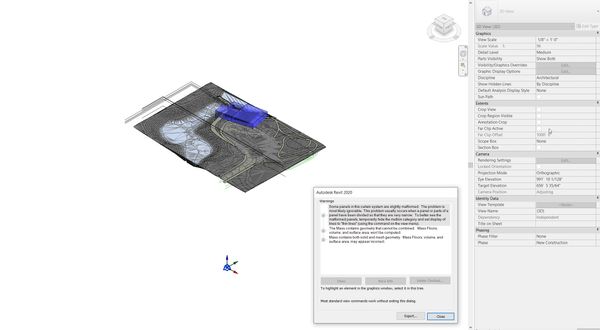

FWIW: Yes, your model is hosed big time.
I went through the Warnings and got rid of the big problems -- most of them associated with the SIP Walls' integrated sweeps, which I deleted from the assembly entirely.  Afterwards,  the Model seems to purr like a kitten.
Model Before:
Model After:
Note: All Model Categories and Phases are turned on is above screenshots. That's why you see those ugly Toposurface triangulations lines.
For your perusal, I've attached my RVT. You can take it or leave it.
