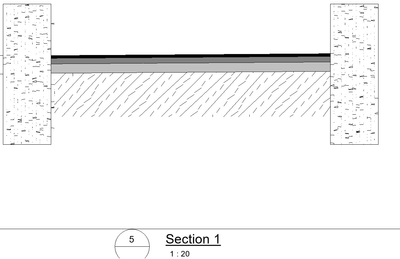

Hi, graphics in Revit is showing different to usual. The view below for example, the fill patterns are not showing correctly, they seem stretched compared to how they should look like, in some places they extend outside of the boundaries, and also the dashed lines not straight. Also when I zoom into any view, the graphics seem to jump, and snap doesn't appear to snap directly on a specific point. However I've checked the snap setting and all seems as usual. Any help appreciated.

Do I you have any cad import or link with the extent too far from the internal origin?

Thanks @ToanDN I think this is the issue. I also have all the modelled elements located more than 10miles(16kM) away from the internal origin / project base point. But moving everything closer to the internal origin / base point would disrupt all the views / viewports etc. Therefore is there a way to sort this without effecting the views / viewports etc?
