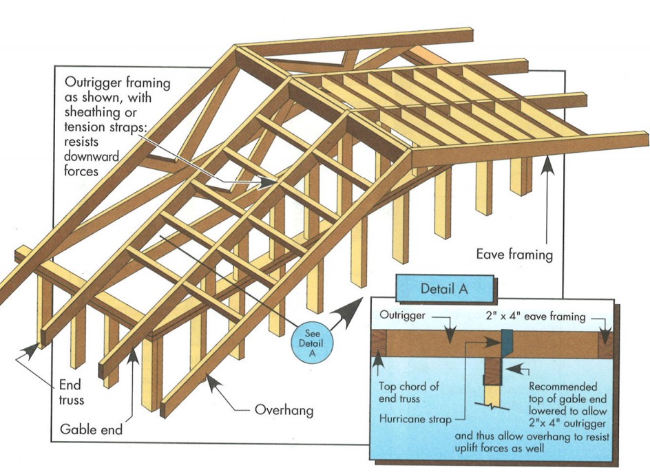

You can see in the picture I've posted that the typical overhang on a gable end is ladder framed to extend out so the thickness in this portion is not the same thickness as the main roof.

The blue roof is not wrong....and I don't have any issues with the soffit. The soffit condition I feel is irrelevant in this. That being said it would be a join condition similar to the third option, flat soffit at eave and sloped soffit at rake. I understand in order to make a soffit to use the soffit tool and it can be either sloped on the underside or it can be flat. My question is regarding the fascia at the gable end. The roof thickness is built with trusses, not rafters. When it gets built as a truss it is considerably wider than a typical 2x10 rafter so the gable end becomes a problem.
I've attached a section thru the roof and wall showing a 2' overhang and a 5-1/2" fascia depth. But you'll see in the second picture that because the gable end is not sloped the fascia depth does not reduce and therefore is the full thickness of the roof in question. For reference the fascia shown is a 1x12 fascia. When building this building in actuality, the fascia will not be 16" wide in order to cover the the gable end, but rather will be the same width all the way around because the gable end overhang will be ladder framed out. The only way I can think of doing it is to make it as 2 roof's - one thick and one thinner. The other suggestion of creating a void sweep and cutting the roof will also work.
