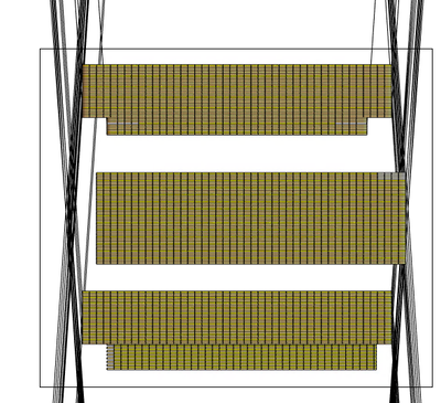

i have created a curve form family using adaptive component
when i go in side elevation, i am seeing these infinite line which only show in side elevation
when i create a wall using that family, in elevation i am seeing these line but not in 3d
thus anyone have any solution on these??

What does the linework identify as?  What are its Properties?
Post the family here if you can't figure it out.

these are not model i guess...but plz find below project file

The only thing I see in the Family that looks remotely like what you are describing is the Tile Pattern Grid.  That Tile Pattern Grid is not carried over to the Project views though.

Are you sure you posted the right RVT? I can't find a single view that shows this:

i have send you different project..but it is same family..
If you go in side elevation u will see the lines

Okay, I found one problem with 1200mm_Horizontal Band.rfa.  The geometry in it isn't constrained properly.  Look what happens when I flex the Grid:
This is likely the crux of your problem.  Open each of your panel families and flex them.

Yeah, you have a bunch of issues - all related to improper constraining.
