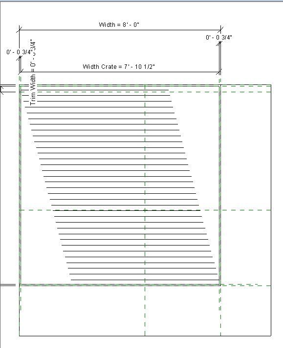

I have uploaded a revit 2016 family, following your steps of nesting a singular tread family inside the main family, and using Instance Parameters & a formula to control the stretch. Everything flewes perfectly until I apply the array. I have attached a screenshot of what happens if I remove the constraints to see how it flexes after the array is applied.
Any help would be appreciated, as I have tried a few things now without much luck.

You are almost there. First you have to make sure that everything flexes in same direction.
You made the carprets strip to flex around the center. Than it will be easiest to flex also crate around center. That is why I added the EQ constraint for the crate (see arrow).
Further you still have to link the width of the carpet strip to the width of the crate so that they flex with the same length. Therefore I linked the width of the crate parameter of the carpet strip to width of crate parameter of the host family (see other arrow).
Louis
