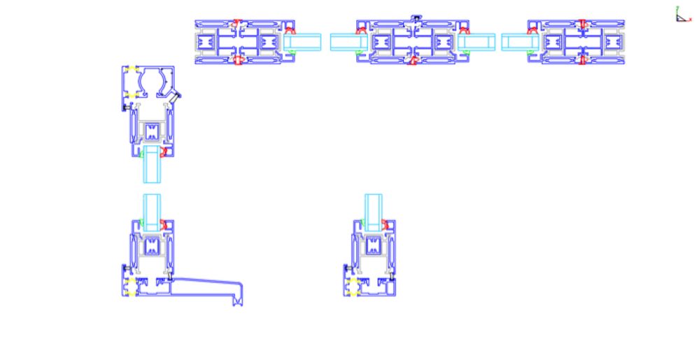

Hi i am looking for some one to write a door family for a slide and swing door (see panoramic doors) is there any one out there who thinks they can help i do not have or know anything about revit this would be so we could pass the file onto other customers at request.

can you send some kind of technical drawings and pictures to explain what exactly you need?
Nachricht 3 von 12
als Antwort auf: FinearcLtd
Many thanks for the reply the door is the one one the video on this site http://panoramicdoors.co.uk so you can see how it works. As for technical drawings please see below jpg. i can supply full cad drawings if this is required we will be looking for 2,3,4,5 and 6 pane sliding to the left and the same to the  right.

I will need dwg file with plan and section detailing, including wall joint working details. Table of min. & Max. Sizes of panels and openings.

I think i have attached all you need in the dwg there is a 2 and 3 pane plan just so you can see how they change with increasing sashes. As for wall fixing they fix through the centre of each touching section so as long as there is a sound wall behind they can be located where needed for the regulations.

Please fine attached the files for you system.
Parameters need to be defined yet for the specifications.
Please let me know which parameters you require and I will add them.
Test the Revit Family and see if you get the hang of it. 3-8 shashes in one family and 2 shashes in another for parametric reasons.
I attached an image of the sample project for your knowledge.
