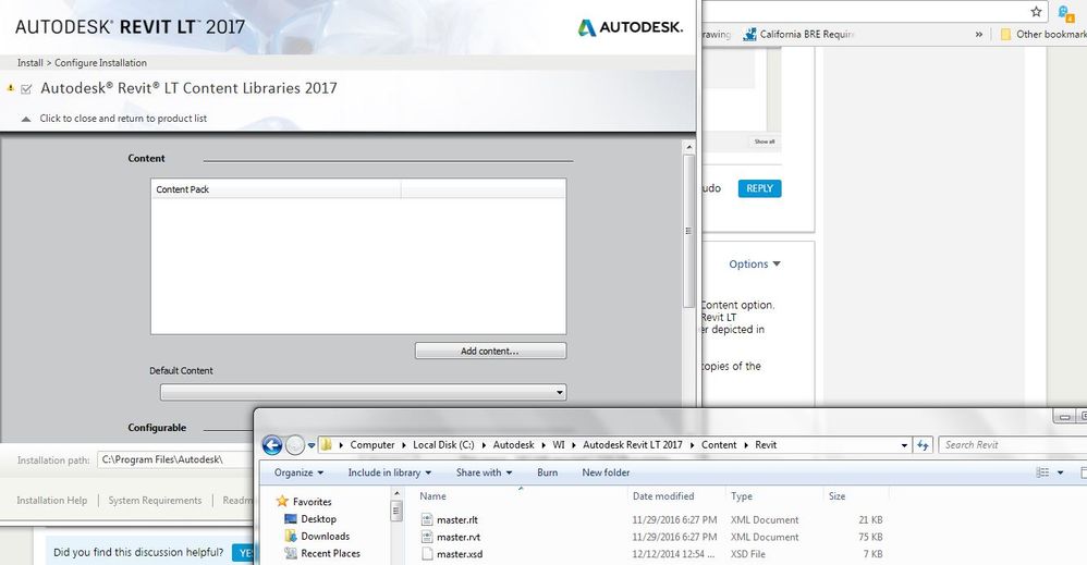

After following the steps, i am still unable to see any content packsreinstall attempt.JPG

Based on your screen capture, it appears that you are trying to load the supplied XML files via the Add Content option. This approach will not work and you must copy the master.rlt.xml file to the C:\Autodesk\WI\Autodesk Revit LT 2017\Content\Revit folder prior to launching the installation. I cannot see the full path to the Revit folder depicted in your screen capture but it doesn't appear to the correct folder because it is missing the master.xsd file.
Another suggestion would be to delete the contents of the C:\Autodesk folder, which will require new copies of the install files to be downloaded.
attached is screen shot showing the full path C:\Autodesk\WI\Autodesk Revit LT 2017\Content\Revit with the master.xsd file.
I also deleted everything in the C:\Autodesk folder and went this route....still no luck.

This is very strange indeed as you definitely have the necessary files to populate the list of content packs in your Revit LT installation.  Another thing to try is to delete the master.rlt.xml file from this location and see if that changes anything.  If not, what is the home location setting on this computer? The answer to this question can be accessed through the Clock, Language, and Region settings in the Windows Control Panel.
