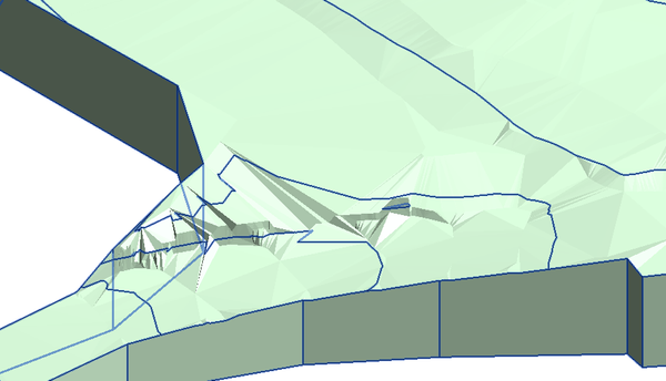

I'm trying to create a easy toposurface from an import CAD but revit 2024 doesn't detect it correctly, any advice or help.
I imported just the necessary layers: Contorno, CV & CVD
I attached a copy of the CAD file if the problem could be there.
I think that it was much easier in revit 2015 than now.
thx in advance

Do you mean inaccuracies like this? Yes, TopoSolids in Revit 2024 aren't as effective as TopoSurfaces were. My advice is to use Revit 2023 for more precise topography

Hello!,
Yes, toposolid is a disaster vitorbortoncello.
