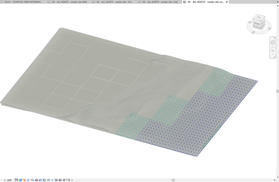

I prepared a DWG with a satellite image to link into Revit.
Everything looks good in AutoCAD but when I link into Revit the aerial photo is not displayed, just geometry.
I linked it in and placed it with default settings with the same unit system for all models.
I also tried different graphic settings in the view and nothing seems to work.
Is there a setting to adjust to see the photo layer of this image when it goes into  Revit?
Graphics below to describe the issue:
The prepared AutoCAD dwg file in AutoCAD desktop showing the topography and satellite imagery:
The DWG linked into Revit but not showing the satellite imagery only the topography in 3D.
The image below is rendered with 'realistic' mode in the 3D view:
