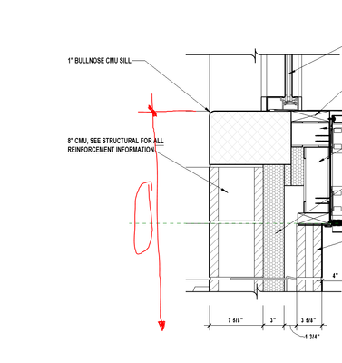

Is there a way to only have one tick mark? For instance, a wall section detail where you are only showing the sill of a window. I would like to have a dimension to the floor similar to this:

Hi! Will you tell please me the steps to make this work? All I see is the end result but not how to get there.

You edit the Dimension Properties and change it to Ordinate, then edit the Ordinate Dimensions Properties.
