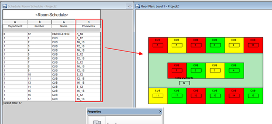

A rough manual control could be used from a Room Schedule made in New Phase of the project.
In my example I used a schematic plan made with Room Separators , but it can be used with cube partition walls too.
I used Department to filter apart circulation from the cubes , and Comments connected to Filters for shifts..
Maybe , not to smart , but could be a way...

Thank you for the responses. I ended up creating rooms with the room separator and tagging them with Shift information and Employee name. There are (4) shifts:
1. All Day
2. Morning
3. Afternoon
4. Telework
