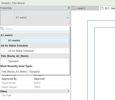

you need to Insert the Family
Insert Tab > Load Family > Titleblocks
alternatively - Insert Tab > Load Autodesk Family
Then when in the Sheet to change the Paper Size - Select the Titleblock in the Sheet then in the Properties Palette > Type Selector Drop Down

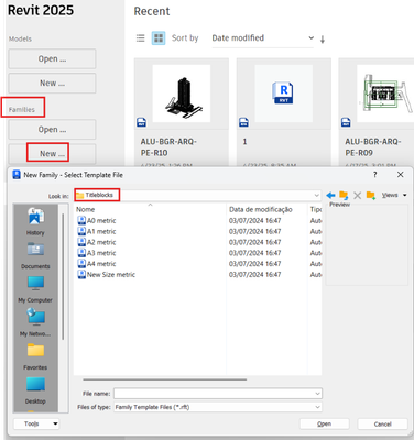

I will share a file with different sheet sizes.
If you need another size, you can create one from scratch...go to: Families - new - Titleblocks - and edit the lines (width and length)

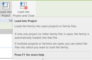

when done, load it into project:
