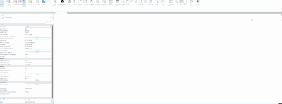

Hi everyone,
I'm facing an issue in Revit 2025 where the blue region that typically indicates the Project Browser's position is missing. Instead, only a thin blue line appears, making it difficult to properly dock or reposition the browser window. This change is not very user-friendly compared to previous versions.
To illustrate the difference, I've attached a video comparing Revit 2024 and 2025.
Has anyone else encountered this? Is there a workaround or fix for restoring the blue region?
Thanks in advance for any insights!
648 Views
RDAOU
@Edina_Hodzic7RWR4
Not really. Why for you it is more difficalt in 2025 vs 2024 is hard to tell but in terms of functionality, it works exactly as expected in 2025.4 (see the GIF below).
This could have to do with the screen's extent versus the set resolution which you are using, causing the application's border to fall slightly off the screen. Restoring the application window could make it easier for you to hover over the app's border.

Make the Revit window smaller, not full size to the edges of your screen, and then dock it. I just did it in my session because I was having the same issue and it worked.

I have reached out to Autodesk about this situation and this situation is now resolved in 2026, yay 🎉 Here´s the link to the article
Yes, that´s one workaround in this situation @bairaktarisc . Thanks!
