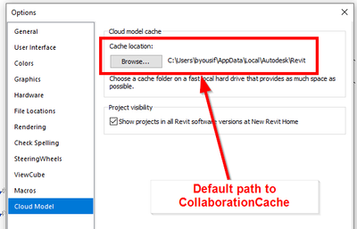

7. In Revit options, if the path to local cache has been modified, please reset it. See screenshot below.
