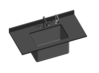

I'm having an issue with Revit creating new assemblies for countertops when they are cut with a void.
I have nested voids in the sink and faucet families which cut the countertop so that I can show the cutouts on my countertop assembly drawings.
This used to work in previous versions, but 2024 is creating a new assembly every time.
If I remove the sink and faucet and copy the countertop assembly it keeps the same assembly name.
Has anyone has a similar issue or found a fix for this?
