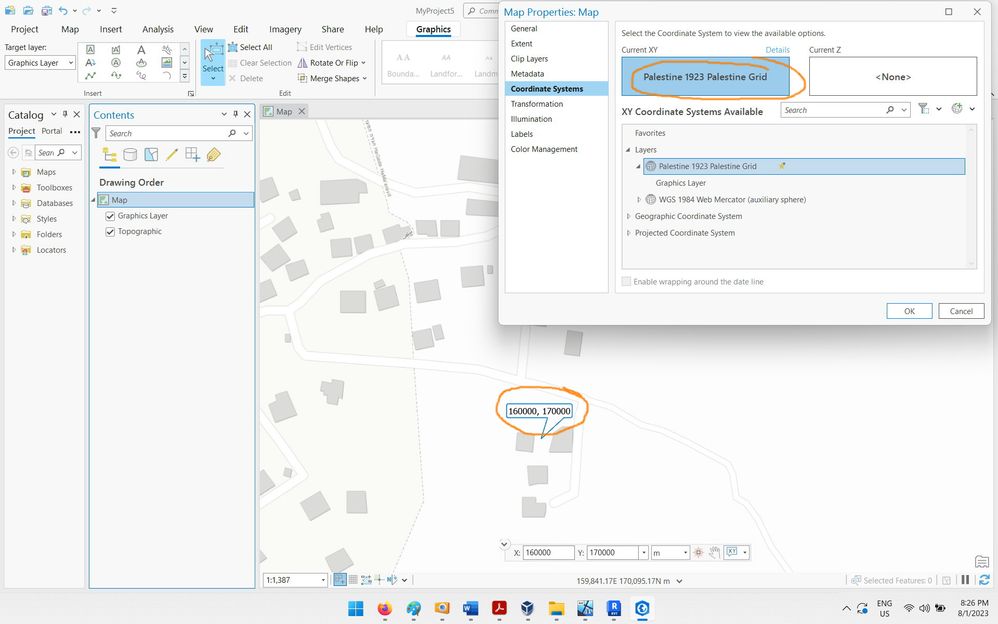

I couldn’t figure out how to define the coordinate system in Revit such that the drwaing gets located in the correct place in ArcGIS Pro
For example, I need to locate the marked edge of the building to be at the point (160000, 170000). How this could be performed?

Export the ArcGIS to DWG with geolocated. Next you link in the CAD into your Revit. Move the CAD to where you building will sit on. Then once you are satisfied with the CAD location, then you acquire coordinates and choose the CAD link. Revit will automatically adopt the coordinate from ArcGIS.

But how to manage all of this in the Revit side given that the coordinate of one of the corners of the building is given which is (X,Y) = (1600002, 170000) as marked in the screenshot below.
Is this point not sufficient to define the coordinates in the Revit?

Unclip the Survey Point and move it to the corner of the building you have known coordinates for. Then use Specify Coordinates at Point and select the Survey Point, enter the coordinates. Now Revit's Shared Coordinate system will allow you to export to DWG format using that points relationship to the WCS origin of a DWG file. Just make sure when you export from Revit is set to use Shared Coordinates system, not the Project.
When you xref the Revit exported DWG to another DWG file and place it's origin (WCS 0,0,0) at the origin of the hosting DWG file they should line up. If the building is rotated on site at all you'll need to know the angle to true north so it will align that way too.
What @syman2000 recommended can make the process a little easier because Acquire Coordinates will do all that for you after you position the DWG file relative to the building as required.

I followed the steps but as the Revit file is added to the ArcGIS Pro it’s not located in the correct place. It’s supposed to be at (160000, 170000) but it is as indicated as marked in the last screenshot

With the help of your useful screenshots and the dwg file you have already attached, I managed to set the GIS coordinate system code the Revit to be “Palestine 1923” in as per the screenshots below. However, as the Revit file is added to ArcGIS Pro if fails to gets located in the correct place.
What other issues I might need to consider?

dwg files can be added directly to the ArcGIS Pro without any required settings either at the level of Pro or AutoCAD. However, the dwg needs to be drawn in the correct place while the coordinate system in Pro needs to be (in my case) Palestinian Grid 1923. The dwg content is positioned in the correct place in the Pro as per the screenshot below
do you mean that I need to convert the rvt file to dwg in order to be able to place it in the correct position in Pro?

I could find a video that explains in details how to stick the Revit file in the correct location in ArcGIS Pro using the prj file
https://www.youtube.com/watch?v=Ap57raSTPx0
  • Use the “specify coordinates at points” command to define the correct location of the project by providing the correct location of one of the known point. In this case the “survey point” will move accordingly
  • Use the prj file for the coordinate system of your preference WITH SAME NAME AS THE REVIT FILE NAME in order to work as a georeferencing file (the rvt and prj files need to be saved in the same folder with same name)
This way the Revit will be positioned in the correct place in ArcGIS Pro
