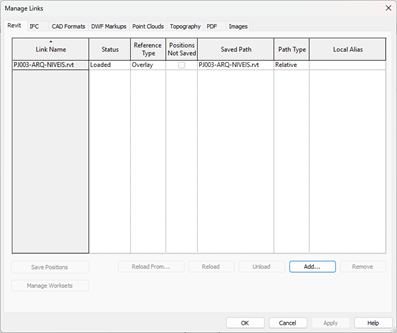

I’ve been using the “Export linked files as separate IFCs” and “Export only elements visible in view” option to export my files, recently I noticed that in Revit 2023 it automatically exports all loaded links, instead of exporting only the links that are visible in the view. So every time I have to export my file, I need to unload all linked files.
I’ve never had that problem using Revit 2021. Does anyone know if that is a bug or if there’s a way to fix it?
IFC Setup:
Linked file not visible in view:
Exported files:
