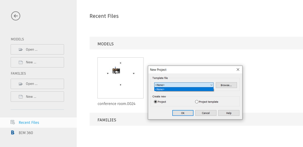

my revit 2021 on the project name bar reads Revit 2021.1.2,what is that?
there are no wall families in the property pane,no options in the same,why?
home page does not display model and family templates,why?
when clicking 'new project',i dont get options to choose the type of template,why?help1.pnghelp2.pnghelp3.png

you need to download the revit 2021 content library and install here
https://knowledge.autodesk.com/support/revit-products/troubleshooting/caas/downloads/content/autodes...
how to install
https://www.youtube.com/watch?v=bWVm8pOely0
