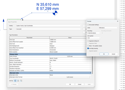

I couldn’t figure out how to display the “thousand separator” for the text in the “spot coordinate” annotation.

Manage->Project Unit-> Length...
Check the Use Digit grouping
and only for one Dimention :
Uncheck Use Project Setting and Check Use Digit grouping

Tick "Use digit grouping"

Thank you for the help. it works fine
