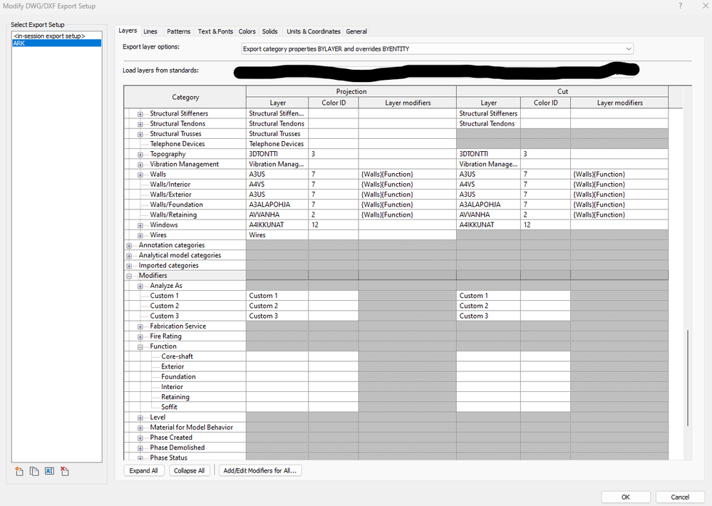

Hi.
I have crashed into a issue that needs solving by tomorrow evening as I will be on parental leave after that for a few weeks. Sadly I cannot post files that show the project.
Exporting a view (not a sheet) from a Revit file to DWG. The problem is that most of the walls export to A3US layer; these should be only exterior walls. I did notice 2 walls that are not on this layer and are on the correct interior wall layer (A4VS). These wall's do not cut on the view.
I did test with one of those walls - that if I raise the height of the wall so that it gets cut - that what would happen. It gets moved to the A3US layer. So the problem seems to be in the cutting of the walls somehow? Are my settings messed up or is this a known issue?
EDIT: I am trying to export as DWG 2013.
EDIT: Added a DWG file with few walls. Seems like the grey interior wall has hatch in the A3US but lines are A4VS, but the new interior wall has everything in A3US.
