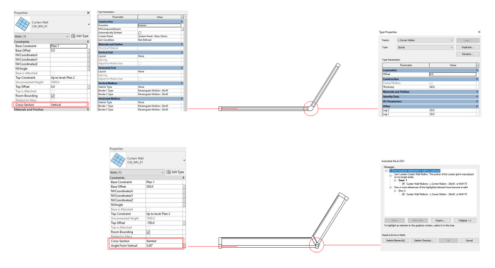

Hello!
I am working on Revit 2021.1.4, and I have problems with slanted curtain walls that would not allow corner mullions at intersections because "The portion of the curtain grid it was placed on, no longer exist".
image.pngI have attached the above test file if anyone is willing to have a look at it. Has anyone had the same experience?
I am looking for a better explanation of the error and any possible workaround!

If you set it in the type (at the border mullions) it will work; however, it will disconnect from the adjacent wall and you will end up with double border mullion...can delete one but the overall alignment of the end result is meh!!! Slanted works better with Quad corner...otherwise, I would
  1. either use a custom mullion instead of the L/Trap corner ones
  2. or model slanted cw using a divided surface + (pattern based or adaptive)

Thank you for the answer! Indeed, I had already tried using the corner mullion in the type property (both L and Quad), just forgot to include the option. here it is.
as you said, it kind of works, but I thought it did not because of the misalignment between the corner mullion and the right panel. Also, if the curtain walls with corner mullions set within the type properties are drawn with "vertical cross-section", and then changed to slanted, the same errors appear.
What kind of custom corner mullion have you in mind? Can you suggest any references?
