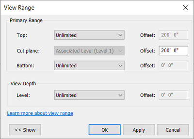

Hi. Once I start a new project in Revit 2020, under floor plans in the project browser there is only Level 1 listed. There is no Site Plan. Is it a new feature of Revit 2020? How can I make a Site Plan view. Thanks.

...maybe not in a Project?
If you are in a Project, You can create a Site Plan View by going to View=>Plan Views=>Floor Plan, untick "Do Not Duplicate Exist Views" and select Level 1 to create a Site Plan from. Then set your desired View Range -- maybe something like this:

als Antwort auf: barthbradley
Hi. Yes, but what would be the view range of the Site Plan, because only in the Site Plan you can work with the Topography.

als Antwort auf: Anonymous
That is not true.  Where did you get that idea?  Do what I described and turn on the Topography Categories in the View.
