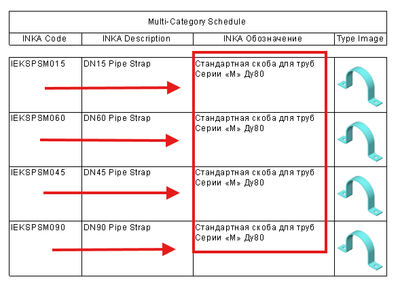

Hello everyone,
When I use the "load to project" button from within the family in Revit to load the family into the project, the description part appears correctly in the schedule. However, when I open the project and call the family into the project, the descriptions for different types appear the same. I would greatly appreciate any assistance with this issue.

Maybe you are overwriting the existing version and its parameter values?
https://help.autodesk.com/view/RVT/2022/ENU/?guid=GUID-25A9F912-180A-4632-8DBD-52D90BF65047
Maybe there's a Revit INI File setting that's causing the issue.   Close Revit, delete the User INI File and restart Revit.
https://help.autodesk.com/view/RVT/2024/ENU/?guid=GUID-9ECD669E-81D3-43E5-9970-9FA1C38E8507

Unfortunately, the issue is not caused by either of them.
Nachricht 4 von 4
I tried deleting the size lookup formula in the description section, and the issue was resolved.
