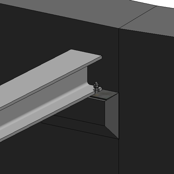

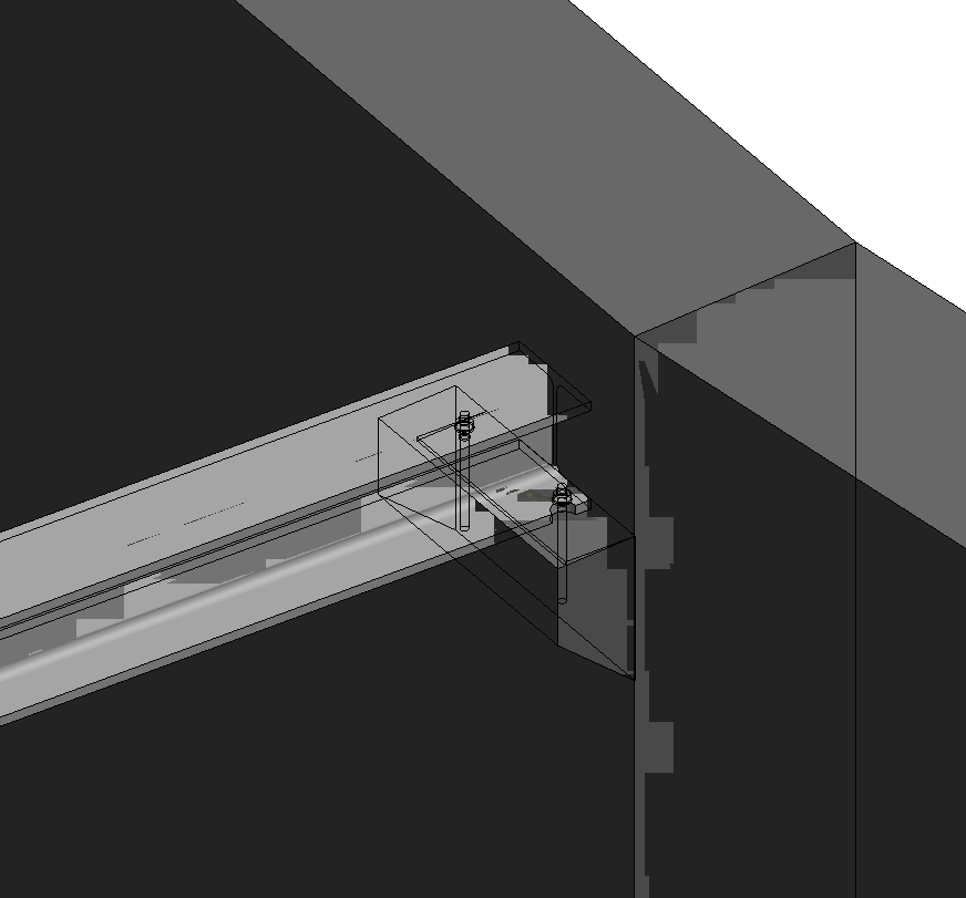

I am currently working on a project on Revit and I am encountering an graphic issue very frequently lately.
It usually occurs 3-5 minutes after opening this project and honestly it is driving me nuts. (see attachments)*
Has anyone of you ever dealt with this kind of issue or is it me? if so, could you please tell me how to fix it?
best regards
Vincent
*graphic_issue.png is how it looks like and graphig_issue_2.png is how it looks like when I restart it

Update:
I just set a few anchors in this project when all of the sudden my object looked like this (see attachments). i cant move using the pan tool and I cant zoom in or out. Also when I rotated using the viewcube everything dissappeared and now it is just blank. luckily I have a backup file.
I think it has something to do with the viewcube because I only encountered this graphics issue right after rotating using the viewcube.

Does the issue occur in this 3d view or in multiple views?  RobDraw is suggesting that your view may be corrupted.  If so, recreate the 3d view.

I had the same problem and my default 3D view would get progressively worse the more i worked in it. I found that setting the view to perspective instead of orthographic solved the problem. I could switch back to orthographic mode then and work away.
