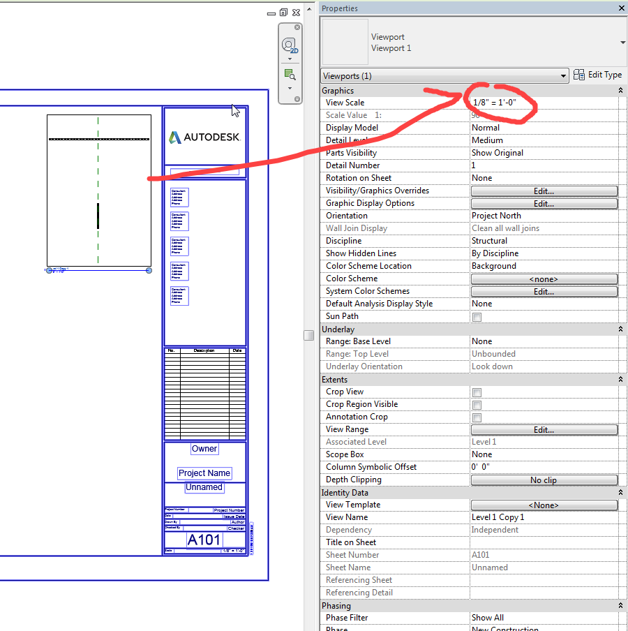

There is no "LTSCALE" like in AutoCAD.  Sheets are 1:1 and 1:1 Views are scaled.

Everything you model is 1:1, real world dimensions. Sheet Views are 1:1 too but the views you place on sheet have their own scale.
If your wall is 10 meters long you make it 10 meters. Since each view you work in can be assigned its own scale, the dimensions you place are designed based on printed size so text is always 2.4 mm for example regardless of view scale. Consider, in AutoCAD we use a scale factor to increase the size of dimensions and text (or more recently annotation styles). In Revit the model is scaled and annotation remains the same. Same result, different logic or approach. Dimensions are also governed by Units, either the Project's settings or the dimension's own override for specific tolerance/rounding.
A stock template has elevation views set up from each of the four ordinate directions. Model inside that "imaginary box/boundary". If your building is bigger, move the elevations farther apart...if smaller...closer together.
Create a sheet view based on a sheet size you need and then place the view on the sheet to assess how well it fits on paper.
