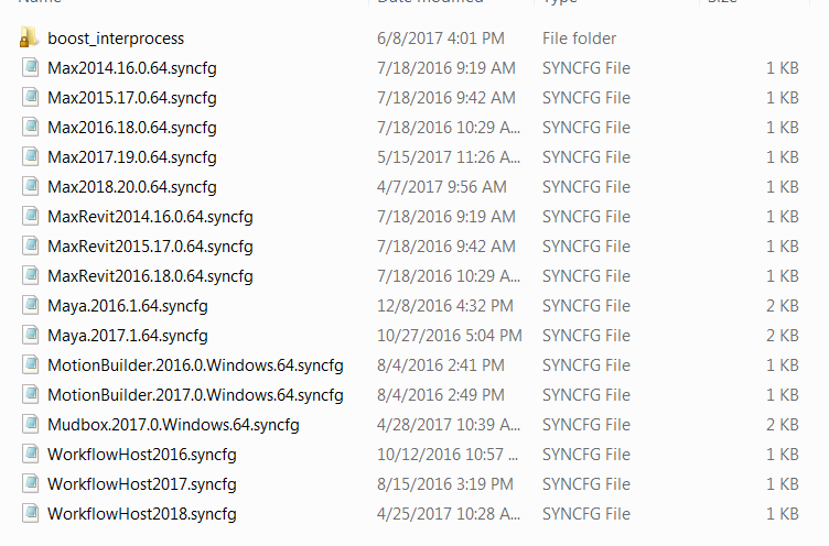

I'm an owner of Building Suite Premium. After installing 2018, I've noticed that all the suite workflow options point to 3d max 2018.
I've created a new suite workflow with the workflow manager, but the option doesn't seem to last after the computer has been rebooted. Als when I was able to see the new option before shutting down, I couldn't get **** to point to 3dmax 2018.
So how do I correct this? How do I get an option to last after the computer has bee restarted, and how do I get that option to point to 3dMax 2018?

Hello @RudyBeuc,
Where was it sending it? Max 2017? Nowhere?
The send to functionality is based on a path located in the C:\ProgramData\Autodesk\Synergy" folder. I have a couple links here that go over this in greater detail. Can you please try this for me?
I don't know a lot about the suite workflow manager, but it may be creating new synergy files that have the path to a different version in them. Here's a screenshot of my synergy folder, does yours have more files in it?

Hey, thanks for the reply, good to hear form you again, but the issue is still the same. Please see my reply to the first message.
Right now both Revit 2017 and 2018 suite workflows point to 3dMax 2017. I would like to get Revit 2017 and 2018 to point to 3dmax 2017 and 2018 respectively.

To @Viveka_CD, this is a Revit problem having to do with a defect in the versioning pointer of the suite workflow out of Revit. Max is the app that it's sending to, but the sending functionality itself seems flawed out of Revit. From what I am seeing, the workflow manager code is still pointing to 2017 installations in Revit 2018. This likely needs to be logged and updated.

Hi @RudyBeuc
I wanted to share an update with you!
The suite workflow option has been identified as a code defect and the following workaround is suggested till the issue is resolved. Looks like there is an issue with the the settings template in Revit 2018 which causes the workflow dialogue to point to 3dsMax 2017
Which 3dMax version will be invoked is decided by the third party component AdWorkflowHost.exe. This component location is specified in the.syncfg file in the \ProgramData\Autodesk\Synergy folder. So we can check if the file content is right. This workaround has already been suggested by @Alfred.DeFlaminis in the post you made at the 3dsmax forum HERE
