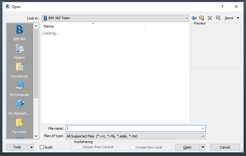

At the moment, neither I nor several people in my office are unable to see the list of projects in the new BIM 360 Team after update to Revit 2018.3, the open screen just sits there not responding. So, we're completely at a work stoppage. This is unacceptable.
We are also without local admin privileges and have no ability to perform a repair as our applications are deployed via Microsoft Software Center.
Nachricht 16 von 36

that might help: https://forums.autodesk.com/t5/revit-architecture-forum/revit-2018-3-update-glitch-solved/m-p/792185...
Nachricht 17 von 36
sburke
als Antwort auf: Anonymous
Unfortunately, no. The setup folder is populated. Running it manually, a warning says it's the 32 bit version of the installer and not the 64 bit. So, perhaps this is the way our update was packaged.

Viveka_CD
als Antwort auf: sburke
Hi @sburke and @Anonymous
Sorry to hear that you are facing issues.
As the first step, please try the solutions in this article.
Since this is after the 2018.3 update, it might be an account syncing issue.
If that does not solve the issue, we may have to look at your account details.
You can also post on the BIM 360 team forum for further feedback.
