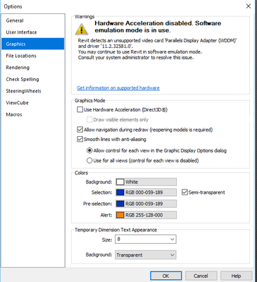

When I start Revit I get this message - can that have something to do with it?
Skärmavbild 2017-02-03 kl. 13.17.35.pngSkärmavbild 2017-02-03 kl. 13.17.35.png
Message 9 of 19
RDAOU
@Anonymous
Could be...You are getting that Prompt message because the graphic card and/or its driver is/are not compatible with Revit...In my signiture below is a link to Autodesk's Hardware compat/requirements ... Check it out and verify if what you have installed meets the requirements.
You should be able to switch off Hardware Accel in the Options/Graphics too or check that box at the "Save Hardware Acceleration Settings" at the bottom of the prompt message so next time you start Revit it will run without Hard Accel
Message 10 of 19
As far as I can tell, my Mac (Macbook Pro Retina mid 2014) isn't supported by Revit. That puts me in a bit of a trouble.
Skärmavbild 2017-02-05 kl. 13.45.29.pngSkärmavbild 2017-02-05 kl. 13.45.29.png

Did disabling the graphic accel fix your issue at least? I can see you can open and work with Revit already...In the OP you mentioned that you get the error as soon as you start revit now not.
Message 12 of 19
It didn't help, unfortunately. The problem occurs when I try to start a new project or open up a existing one. So I can start revit, look through the settings and as soon as I start a project it crashes.
If try to check the box "Use hardware acceleration ...." I get the message saying that "Hardware acceleration disabled".

If you need to run Revit on Mac, use bootcamp.
Message 16 of 19
Message 17 of 19
dgorsman
Agreed.  Parallels only emulates the Windows OS inside the Mac OS.  System-sensitive things like graphics drivers frequently don't work properly under emulation.  Dual-booting with Boot Camp runs the actual Windows OS on the computer, giving full access to the resources.  There may still be a few bumps but its the best option for hardware intensive programs like Revit.
