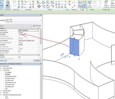

after making wall
section lines between walls and floor doesnot appear in 3d

@Anonymous hello, try to untick your 3d hardware acceleration and set your detail level to fine and see if helps. thanks

i think the problem in revit
see the picture

i have many levels
i draw wall in zero level and make floor in the above level

@Anonymous Hello, the reason is your wall blocking the floor that's why you don't see the lines or cut short your walls up to the finish floor. Thanks

i need the floor under the all walls

@Anonymous hello, then you need to cut short your wall to the finish floorif you want to sse the lines. thanks
