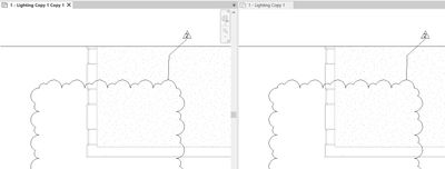

Hello, I'm new to Revit and therefore need some advice on revision tags. Everytime I copy a view as duplicate with detailing, the number on my revision tag chages to a question mark. This is the case even if I create a new revision tag in my duplicated view. How can I get a duplicated view with a Revision tag number on it?

I generally use the revisions on sheets, does that rev let you change the sequence number on properties panel?

I'm working on and i have not that problem which revit version is? could you share the file?

found it go to revisions and change the numbering to per project all will works

Thank you for your reply. It worked. If I place the view on the sheet then the revision number is assigned and it appears. Thank you again!
